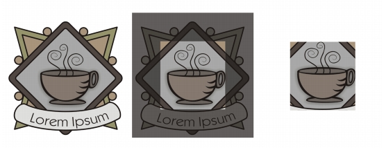

Cropping objects
Cropping lets you quickly remove unwanted areas in objects and imported graphics, eliminating the need to ungroup objects, break linked groups apart, or convert objects to curves. You can crop vector objects and bitmaps.
Cropping objects
When cropping objects, you define a rectangular area (cropping area) that you want to keep. Object portions outside the cropping area are removed. You can specify the exact position and size of the cropping area, and you can rotate and resize it. You can also remove the cropping area.
You can crop only selected objects without affecting other objects in a drawing, or you can crop all objects on the drawing page. In either case, the affected text and shape objects are automatically converted to curves.

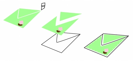

You can split a bitmap or vector object in two and reshape it by redrawing its path. You can split a closed object along a straight or jagged line. CorelDRAW lets you choose between splitting an object into two objects, or leaving it as one object composed of two or more subpaths. You can specify whether you want to close paths automatically or keep them open.
From left to right: The Knife tool creates two separate objects from the green rectangle. Then, the two objects are moved into an unfilled black object to create an envelope.

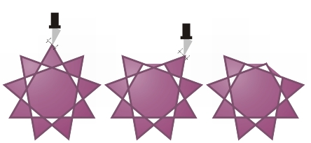

You can also delete virtual line segments, which are portions of objects that overlap each other. For example, you can delete a loop in a line that crosses over itself, or loops in line segments in which two or more objects overlap.

To delete a virtual line segment Back to Top
In the toolbox, click the Virtual segment delete tool .
Move the pointer to the line segment you want to delete.
The Virtual segment delete tool snaps upright when positioned properly.
Click the line segment.
If you want to delete multiple line segments at one time, click the pointer to drag a marquee around all line segments you want to delete.
The Virtual segment delete tool does not work on linked groups such as drop shadows, text, or images.
