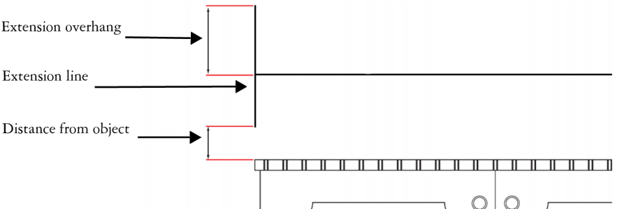

Dimension lines cannot be used for measuring the length of curved lines, but you can easily view the length of a curve in the Properties docker. For more information, see To view curve properties.
Arrowheads are reversed when a dimension line is too small.

| To customize extension lines |
| 1 . | Select a dimension line. |
| 2 . | On the property bar, click the Extension line options button |
| 3 . | To specify the distance between the extension lines and the object, enable the Distance from object check box, and type a value in the Distance box. |
| 4 . | To specify the length of the extension overhang, enable the Extension overhang check box, and type a value in the Distance box. |
