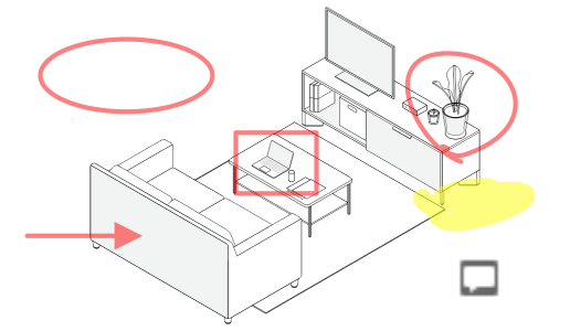

To use drawing markup tools Back to Top
Click the Arrow Markup tool . In the drawing window, drag to draw the arrow. To add an arrowhead at the start point, enable the Start arrow check box.
To draw a straight line, disable the Start arrow check box and the End arrow check box. Point to where you want to start the line, and drag to draw the line.
You can choose the color of arrows and lines from the Line color picker before you start drawing.
Click the Highlighter tool , and drag across the area you want to highlight.
You can choose the color of highlights from the Highlight color picker before you start drawing.
You can specify the width of highlights in the Highlight width box before you start drawing.
Click the Freehand Markup tool , point to where you want to start, and drag in the drawing window.
You can choose the color of lines from the Line color picker before you start drawing.
You can specify the width of lines in the Line width box before you start drawing.
Click the Rectangle Markup tool , and drag in the drawing window.
You can choose the color of the outline from the Outline color picker before you start drawing.
You can specify the width of the outline in the Outline width box before you start drawing.
Click the Ellipse Markup tool , and drag in the drawing window.

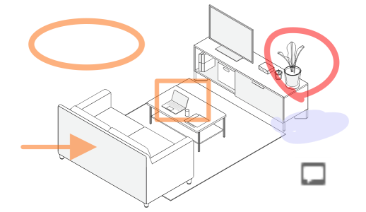

Select the Rectangle Markup tool or Ellipse Markup tool , choose a fill color from the Fill color picker, and then drag in the drawing window.
Customized markup
50% transparency is applied to the colors of the markup.
To resize comment marks Back to Top
The rectangle was resized to focus on a specific area of the design.
