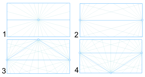

Corel DESIGNER provides presets for three types of perspective: one-point, two-point and three-point perspective.
Perspective types: (1) one-point, (2) two-point, (3) three-point (worm’s-eye view), (4) three-point (bird’s-eye view)
