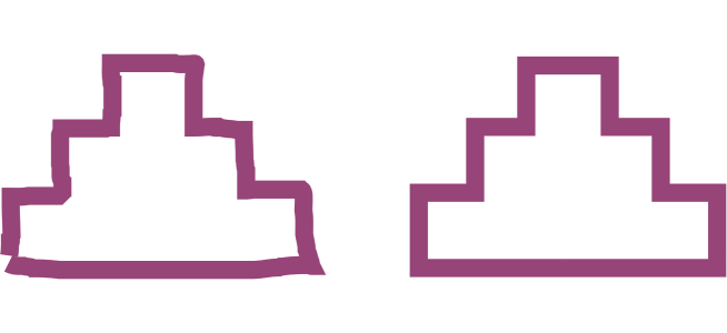

Shapes created with the Smart drawing tool are recognized and smoothed.
