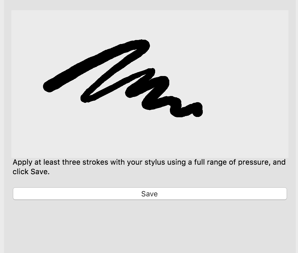

To adjust pen settings
Back to Top
1 Click Corel PHOTO-PAINT menu Preferences Corel PHOTO-PAINT.
2 Click Pen settings.
3 Using a full range of pressure, apply three strokes.
To save the settings as a preset, click Save.
