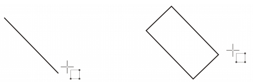

You can create a 3-point rectangle by first drawing its baseline and then drawing its height. The resulting rectangle is angled.

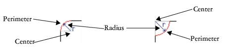

To draw rectangles or squares with rounded, scalloped, or chamfered corners, you need to specify the corner size. For rounding or scalloping a corner, the corner size determines the corner radius. The radius is measured from the curve’s center to its perimeter. Higher corner size values produce more rounded corners or deep scalloped corners.
From left to right, you can see the radius of a rounded corner and the radius of a scalloped corner.

In the toolbox, click the 3-point rectangle tool .
In the drawing window, point to where you want to start the rectangle, drag to draw the width, and release the mouse button.
Move the pointer to draw the height, and click.
