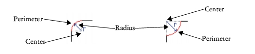

You need to specify the corner radius to determine the size of a filleted or scalloped corner. The radius is measured from the curve’s center to its perimeter. Higher radius values produce more rounded corners or deeper scalloped corners.
From left to right, you can see the radius of a filleted corner and the radius of a scalloped corner.
