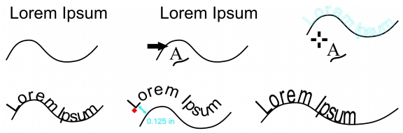

Text and curve as separate objects (upper left), choosing a path with Fit Text to Path tool (upper middle), aligning text while fitting it to path (upper right), text fitted to path (lower left), interactive feedback about offset distance (lower middle), and text and curve stretched horizontally by 200% (lower right)
