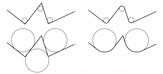

If a fillet, scallop, or chamfer value is too high, the operation is not applied to some or all of the corners. This occurs when line segments aren’t long enough to apply the radius or chamfer distance. Even if the line segments appear long enough at the beginning of the operation, you must consider that the line segments shorten as the radius or chamfer values are applied across the object.
In the example above, the circles represent fillet radius settings. The upper lines show the proposed fillets on the left and the successful results on the right. The lower lines also show the proposed fillets on the left, but the results on the right show that not all corners are filleted. After the first fillet is applied, the next corner can’t be filleted because the line segment isn’t long enough. This corner is skipped, and the final corner is filleted.
