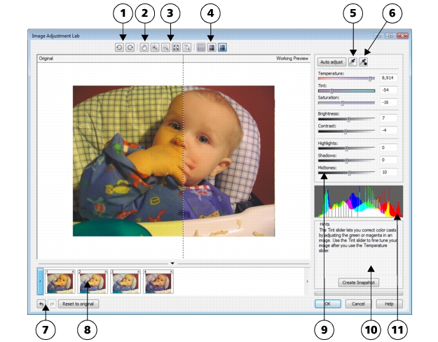

The Image Adjustment Lab consists of automatic and manual controls, which are organized in a logical order for image correction. By starting in the upper-right corner and working your way down, you can select the controls you need to correct the problems specific to your image. It is best to crop or retouch any areas of the image before beginning the color and tone corrections. For information about cropping and retouching images, see Cropping images and Retouching.
While you work in the Image Adjustment Lab, you can take advantage of the following features:
Create snapshot — You can capture the corrected version of an image in a “snapshot” at any time. Thumbnails of the snapshots appear in a window below the image. Snapshots make it easy to compare different corrected versions of the image so you can choose the best one.
Undo, Redo, and Reset to original — Image correction can be a trial and error process, so the ability to undo and redo corrections is important. The Reset to original command lets you clear all corrections so that you can start again.
1. Rotation tools
5. Select white point
9. Sliders
2. Pan tool
6. Select black point
10. Hint for current tool
3. Zoom tools
7. Undo, Redo, and Reset
11. Histogram
4. Preview Modes
8. Snapshots
